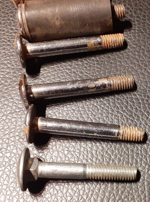

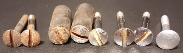

Had nothing better to do so went for a hunt
Found seven of them, used (and some abused) of which two complete.
Also found that bolts DIN603 (or ISO8677 and available in Stainless) have nearly the same head as the Ducati screws and are available in M6 x 45 mm (just a tad longer).
The head has a diameter that is just a bit bigger, but turning it down in a lathe produces the correct height of the outer ridge.
Leaves You just to cut a groove into the head and polish them.
My supplier is about half an hour away and should stock them (22*30 here now).
The 4 left have rust and damaged grooves, then 1 acceptable and 2 nearly new (and shiny). Right the DIN603.
On the other pic You can see the nearly identical head.
Also look on a popular auction site : gio655 has some NOS covers, maybe he has some NOS of those unobtainiums also.
I think they are the same as the GTL350/500.
