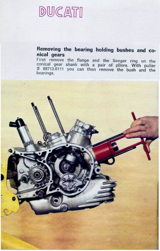

Hi, I've noticed the meshing of this central bevel gear (the one on the distributor shaft) with the individual shafts is a long way out. Does anyone know where I can get a hold of one of these special extractors? Its referenced by part number 887130111.
Re: central bevel gear extractor
Hi Jake,
Bit confused .. That puller is for pulling the bearing bushes of the drive shafts - as illustrated and described here:

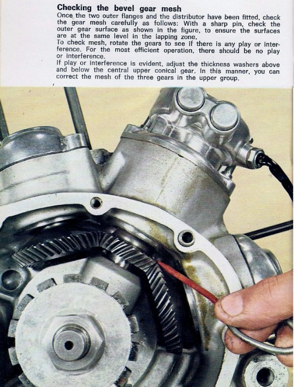

Is that what you're intending to do? If so, I'm not sure it's gonna help you get a better mesh. The factory advise you to adjust the mesh between the bevel gears by using shims on the distributor shaft- see below:

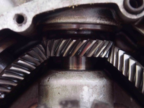

hey craig, yes that the one, the central conical bevel gear. I thought I needed that extractor to pull it out from inside the distributor hole and put in some shims. How does one go about getting a proper mesh between the three bevel gears? Mine is a good millimeter and a half out, the central gear is only just touching the upper half of the teeth on both pinions leading to the top ends! I could probably use washers instead of shims...

When checking the mesh you do need to check it at the ground areas on the gears, it's a flat area that the factory did when the gears were matched. I had to replace one of the cyl. drive gears once, it is a very time consuming operation!

Well, I'm quite sure that the central bevel needs to come down by quite a ways, it can't be good for the engine running on the tips of the teeth like this? So, I'm following Steven Eke's book and I think I need to get a hold of a special tool to pull it out from the top and put in some shims/washers?

guzzijake wrote: Sat Jan 19, 2019 4:44 am hey craig, yes that the one, the central conical bevel gear. I thought I needed that extractor to pull it out from inside the distributor hole and put in some shims.
Ok, got you Jake. One for sale here. It's expensive, but you might be able to sell it on again (on the 860, you can just tap out the bush from below. But I guess - I don't know - that that doesn't work on the 750?)

wdietz186 wrote: Sat Jan 19, 2019 3:21 pm Is there play in the dist. drive gear or the tower shaft gears? That may be the way it left the factory. Dropping the gear down [if it can be done] may bind them up and raising the tower gears would introduce too much play. Is it quiet when running?
To get the center bevel out it looks like the crank need to be out of the way so it can drop down far enough. The factory must have set up the drive gears before the crank was installed. I remember reading the engine was very labor expensive to produce, probably explains the exemplary paint and chrome quality along with the superior electrical system.
Cant see how dropping it down would bind them up, they are running on the edge of the teeth now, have a look at the picture. I wouldn't have a clue how it runs, there was no compression on the upright cylinder (valves were closed up and not sealing), it was covered in bird dog doodie and in pieces. I didn't want to attempt starting it without giving it a moderate once over. I've done the top ends, got the compression up, replaced some rocker arms, re-set the mesh of the top bevels (they were miles out) and thought that, given how far the top bevels were out, I ought to have a look under the stator cover.
