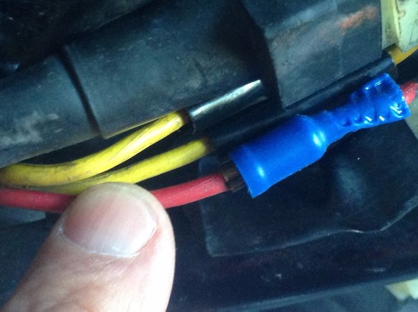

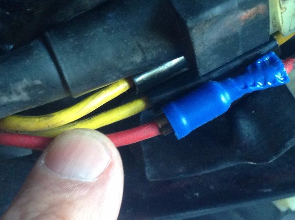

I just bought this bike and it has an after market (I believe) regulator. There are 3 wires coming from the alternator, but only 2 are connected to this regulator. The 3rd (red/black) is extended and connected to positive post of battery. Bike is not charging battery, hence my search for the reason. I wanted to see if the alternator was sending enough volts and was looking for connection points (this new regulator doesn't have exposed connectors, only wires coming out). So, I see the red/black wire NOT going to the regulator and thought that was strange. Now I need help. I can't find a wiring diagram, nor any posts to help. Many thanks for any help. peace

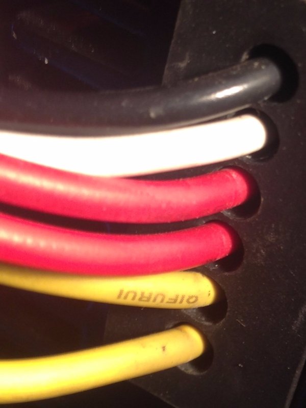

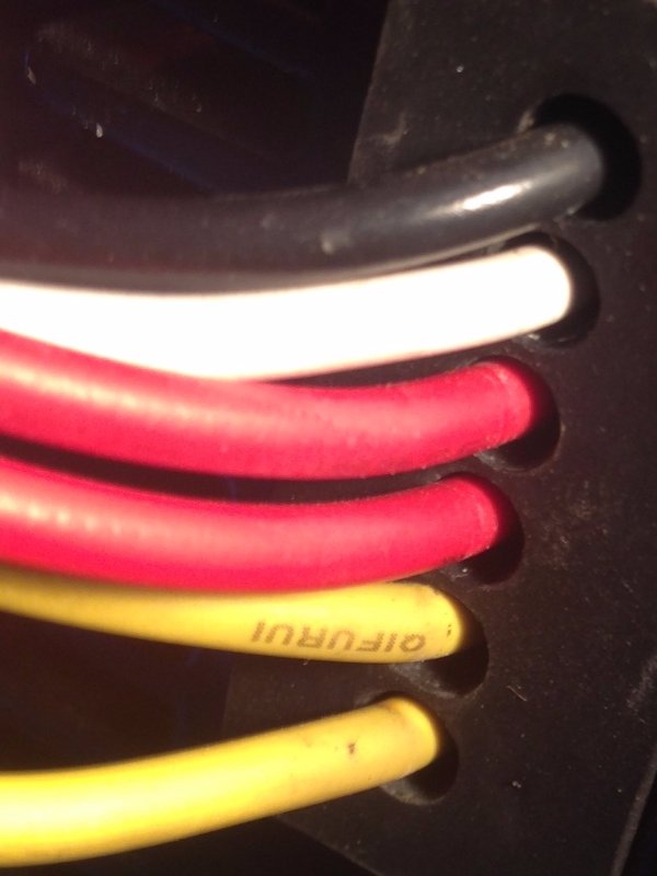

Steve,
I believe this is an after-market regulator that came from Bevel Heaven. Pictures show 6 wires, where the stock regulator in the diagram shows 4. Only the 2 yellow wires from the alternator are connected to the regulator. The red wire from alternator is connected to the battery...too weird.
Any ideas? peace
Any ideas? peace

It must be in the air, both Italian vehicles are having electronic issues
On the Ducati, I am at a stand-still. There are 6 wires coming from after-market Regulator and the wiring diagram from Steve only shows 5. AND, not the same colour code. If you look above, you will see the wires. This previous owner took the 2 yellows from Alt. and joined them with the 2 from regulator. The red from alternator was left "hanging". The black from regulator goes to negative, battery. The 2 reds from regulator go to positive side of battery. The white from regulator "hangs". Since this bike is a 3-wire alternator, the previous owner must have decided to follow the 2-wire diagram.
My question, Steve: With the set-up I received the bike in, and if the alternator is good, will the battery be charging while engine runs...again, based on the wired set-up. OR, is there another wiring diagram for the regulator that shows 6 wires and what to do? Many thanks, Steve...or anyone else:-)
The Gen. light stays on and battery went down on last ride.
