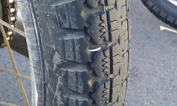

So my rear tire on the Mach 1 was completely shagged after putting 2000kms on it on the MotoGiro (plus 80kms of gravel roads and a showering of battery acid after my battery exploded) so I've had to get a temporary rear tire (a front Battlax was the only thing they had in a size that would fit)
