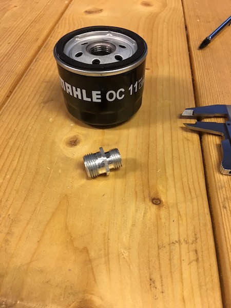

Re: Mille S2 Oil Filter
Is this the filter that you use...
https://www.rexbo.eu/mahle/oil-filter-oc11?c=100259
If so, the thread is 3/4"-16UNF-2B
I bought a Pantah spigot but that one was M16x1.5 i both ends.
Best regards
Hedton
Best regards
Hedton

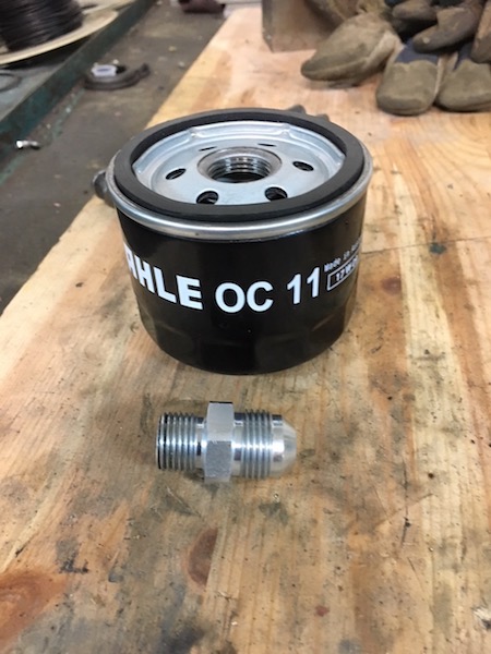

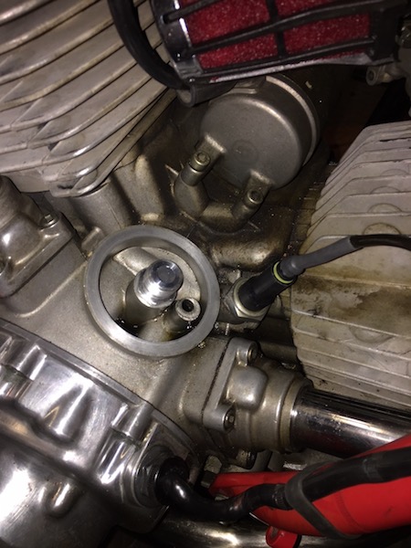

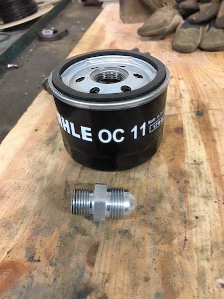

I bought this.......
http://www.ebay.co.uk/itm/AN-8-AN8-BLAC ... xy5jxSbx-F
Ebayitemnr:302337834959
With a little machining you can fit a 3/4 UNC filter such as the OC11.
I will take off the anodizing with 5 % of plumbing soda.
Hope this information is useful.
I've modified the spigot i bought.
And the Oc11 filter will now fit.
