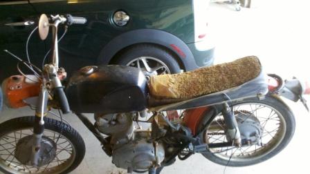

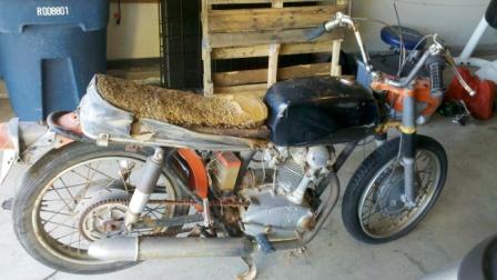

I got this bike for a steal and want to restore it. I think it is a mid-late 60's Monza 350 OHC.
The forks are shot, the tank seems to be original and has no dents. The engine is is decent shape. I took the case apart to do some investigating. The piston was rusted to the cylinder wall, but after a night of WD-40 it broke loose. Other than needing a new sleeve and piston, the engine is superb-no fins are broken and it still had oil in it. The electical system is also completely gone.
I would really appreciate some advice on where to go with it. I am thinking either a full restore or a cafe racer. My end goal is to ride it. I am a classic car guy and have never done a bike, but I love classic Ducatis and am excited for this challenge.
Also, what should I expect to pay for a project like this?

If you decide which way you're going to go on it, if it's restore, keep me in mind. I'm cafe'ing a 66 350 Sebring, that was mostly complete. I might have a few parts you could use. Side covers, chain guard, front fender, forks, etc. Nothing's perfect, bike sat in a barn for a few years (decades).
Also, I think you're bike is a 66 or 67 Sebring, if the motor really is a 350. The Monza was a 250, everthing else being the same.
