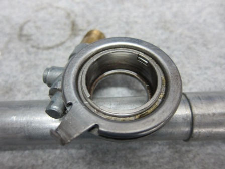

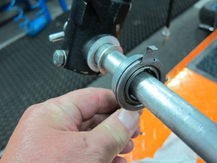

Here's some pics at last, I keep wondering if I have somehow substituted another drive or a bit has fallen out, and my grey cells are too rotten to remember... Oh well!
'75 900 SS
- Posts: 2404
Re: '75 900ss front axle/speedo drive weirdness
looks like you have lost the inner sleeve. start hunting. The speedo drive should slip over axle with a very small clearance, the ID should be 20.2mm
You are definitely missing a sleeve inside that speedo drive.
HTHBevHevSteve wrote: You are definitely missing a sleeve inside that speedo drive.
