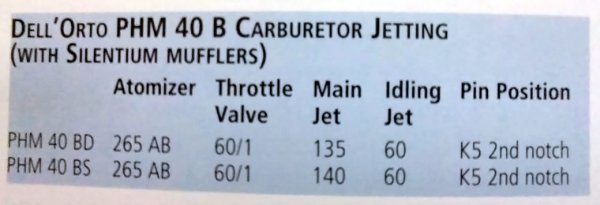

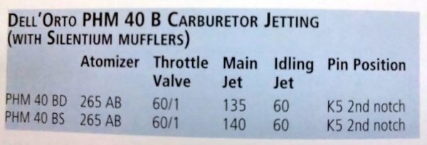

A supplement to my previous message ...
Just found this in Ian Falloon's "Original Ducati Sport and Super Sport".
So pretty much the same, just a smaller idle.
