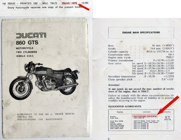

No worries. "Why not a straight 50", you ask.
Well, I was teasing you a bit; but more seriously, it's just that oil technology has move on so much since the 1970s. And remember: as early as March 1976, Ducati themselves recommended a synthetic 10-50 :shock:
And if you use a modern synthetic 10-50, you won't need to do an oil change during your trip. Synthetics have a much longer life than any mineral oil.
Your only possible problem is that changing might give rise to an initial amount of clutch slip. The solution is simple. Pull the clutch, wash all the plates in paraffin, roughen up the friction plates if required and refit.
But if you're happy with Dino Juice, don't let me argue you out of it :)
