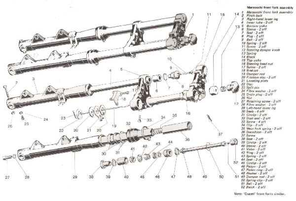

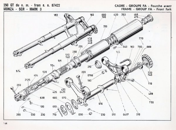

I've also been going off of this schematic :
Are there any better or more useful manuals for this fork?

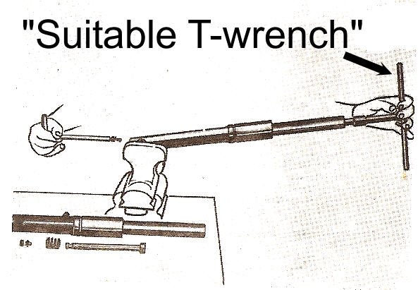

If you are asking about getting screw #27 out of the bottom so everything comes apart, its easy to do just use an impact gun before you take the top cap off meaning, while everything is under tension. To put back together use an impact doesn't matter if the spring is holding pressure or not it will spin fast enough to grab and tighten.
Re: '66 250 Scrambler fork questions
As Steve, Erik. You just need to block the rod from turning. So either 'surprise' it by using an impact gun. Or fashion up what Ducati called a "suitable T wrench".
Here's the Ducati illustration of the "suitable T-wrench". Not very helpful, it has to be said.
That fork manual you are using is not the correct one. Ok, the working principals of a telescopic fork haven't changed much over the years; but that manual is for a much later model from the 1980s, complete with provision for brake discs!

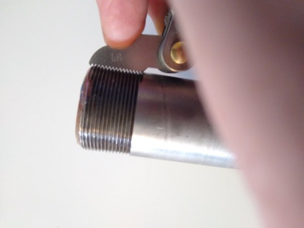

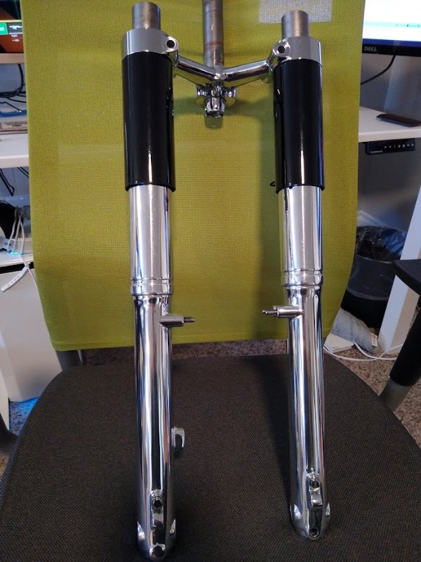

The owner wanted to have the fork's "bottom yoke" chromed, along with a lot of the other parts. Unfortunately the folks that did the chroming decided to attach one of their dipping cables to the head tube threads. They didn't clean it up at all and so I was left with having to deal with it. After some very careful filing I got the threads cleaned up pretty well but the shaft securing nut on the damper won't screw on so I believe I need to hit it with a die to clean up the threads. I've searched the webs all over but cannot find the official thread pitch and diameter for this. My measurements show it to be either 25mm or 1 inch diameter with a 1.0 thread pitch being the closest. I'm hoping someone can confirm this. I'll attach a couple pics and of course a pic of the fork itself so you can see the prettyness.
26 x 1, the part number for the nut being 0460.37.110.
(I guess you're aware that the threaded end of the steering stem should be on the top not the bottom?)
