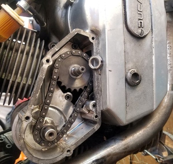

Re: '78 darmah sd - what's this noise?
thanks, steve.
i never got that far; here's what i found when i removed the starter cover: the nut on the spindle that turns over the motor was off the shaft. no noise w/the engine running, now that it's back on; also no noise when turning the chain sprocket by hand, per my 2nd video.
but, after i buttoned it back up, i then checked the service manual and parts list; according to those, there should be a shim/bush between the sprocket ring nut, and the starter motor cover? and a washer after? (and similar on the starter motor shaft?) and the washer between the ring nut and the sprocket should be a lock washer? the washer there was completely flat, not wavy. there were bronze bushes in the starter cover for the starter motor and the spindle that turns over the engine, but it seems these aren't the shims being referred to, in the service manual? the parts manual is less clear. i didn't see or hear anything fall out, or into the crank case cover, is what i have ok? should i pull everything off again, including the left side cover to see if anything fell in there, when i pulled the starter cover off?
also, i did use permatex med strength blue gel threadlocker on the sprocket ring nut/shaft.
thanks again,
doug s.
thanks again,
doug s.
well, to be safe, i opened everything up again, and got into the clutch - no issues there (and no parts dropped down from the starter). i buttoned everything back up, and while i still hear a clacking, it's not really that bad - maybe it's always been there, and i'm just overly sensitive, since i snapped the chain?
also, interestingly enough, the starter motor chain had its retaining clip on the inside; i wonder what the mechanic did when i had my used rebuilt starter installed a couple years back, along w/the valve adjustment?
thanks,
doug s.
thanks,
doug s.
one final thought -
the only thing i'm wondering about is the larger shaft/sprocket that the starter engages to turn over the engine - there was some fore/aft movement when the starter cover was off. (not slight left-right movement, from the bike's orientation, but fore-aft movement, which is allowing the starter chain to go slack or tight). is this normal, or should it be in there rigid?
thanks,
doug s.
thanks,
doug s.
The outer cover has two bushings, one for each shaft to engage so with the cover on, there should be no play in the sprocket shafts.
thanks, steve.
yes, i'm sure there's no play in the larger sprocket shaft when the cover is on; i was wondering about when it was off; if the front-to-back play is normal, so that the chain gets some slack when the sprocket/shaft is moved forward.
thanks again,
doug s.
thanks again,
doug s.
- Posts: 2393
normal slop in the system without the cover in place. Also there should be a small shim on each so you don't wear through the cover.
