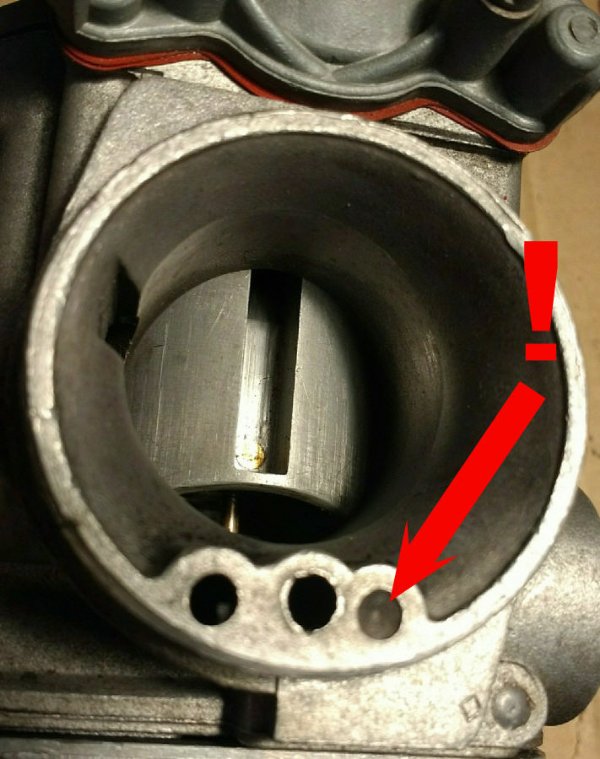

I am putting new bits in my PHF32As and checking all the passages. As you face the intake side of the carb, there are three air intake holes at the bottom of the main bore. The hole on the right seems hard to pass air or solvent through and this is true on both carbs. Where does this passage go? what does it do? and how easy should it be to blow air through it ? I seem to be able to only pass a tiny airflow through it . When I shine a bright light down the passage , it looks clean but there is what looks like shiny metal way down in the center of the passage. Could this be blocked off at the factory? Both carbs behave this way.

It's a blind drilling!
See the photo below of a Dell'Orto PHF32AD which shows it ... more clearly
The most important thing is to make sure that the drilling on the left is really clear. It is stepped internally which makes a great place for fuel crud to accumulate. And since it supplies air for the idle circuit, it needs to breathe free.

Ah! I can understand your confusion ...Tinkerbell wrote: Sat Sep 12, 2020 6:11 pm<snip>The hole on the right seems hard to pass air or solvent through and this is true on both carbs. Where does this passage go? what does it do?

Brilliant! I looked with a glass way down inside and it looked like a bronze color plug but I am new to the PHF world. All the other passages blow clear and the carb was spotless inside upon disassembly. THANK YOU for moving the project forward!
