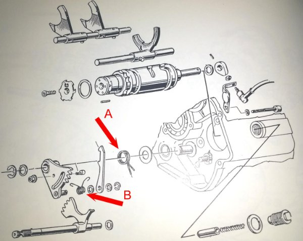

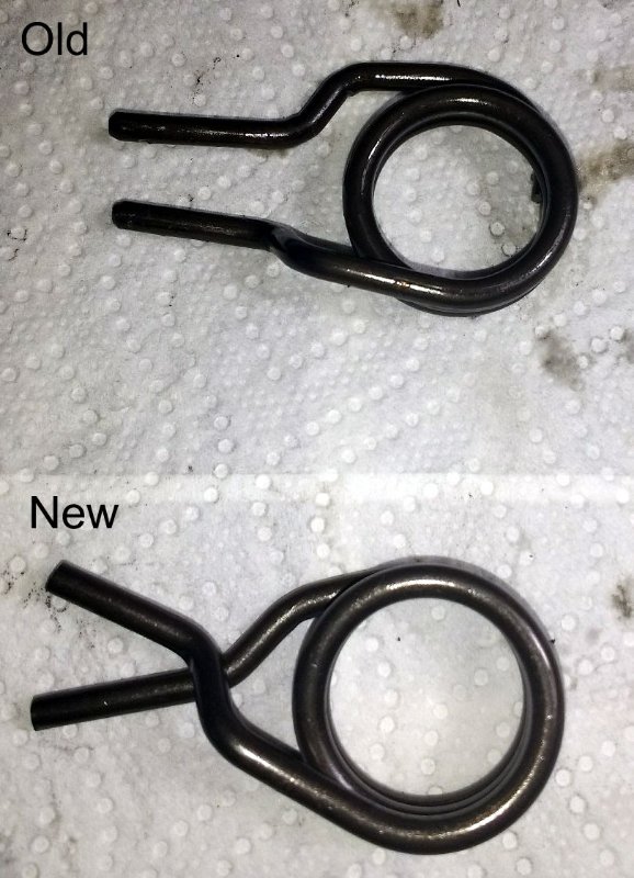

The other contributory factor might be a weakening of one/other/both of the two return springs - see the scan of the parts book below. The return spring of the gear lever itself (A) is a well-known weak point - had them fail on both my MHR and my SSD. The photo shows how knackered they can become. Eventually, the spring snaps.
The other one is the return spring for the detent mechanism (B). Just done this one ...
