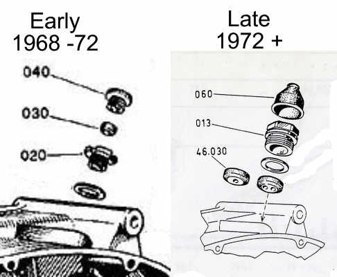

engine is from another bike . it has the large M 30 alternator outlet . early widecase had M 22 outlets . on the plus side those crankcases are stronger and have the bigger 6306 righthand main bearing

Good one, Eldert - thanks!Eldert wrote: Fri Jun 05, 2020 8:38 am Engine is from another bike. It has the large M30 alternator outlet . Early widecase had M22 outlets.
