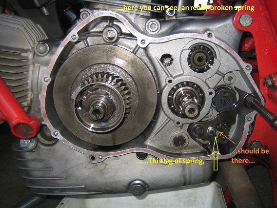

Hello,
i´ve just done this job also this week on my MHR,...last weekend on tour, it was more and more difficult, to shift down, especially to the 2 lower gears, upshifting was no problem,..but to shift down was only possible with a lot of tricky fumbling with my foot... :(
So, i had assume, that the selctor-return spring is broken,...and so it was: After taking away the complete clutch assembly, the problem-zone was visible,...and the broken spring! - I had bought it same day,..and changed it in the next hour. After completing the engines left side, it was al, as it should be: Smooth operating shift linkage, with an shifter-pedal in the perfect middle position :-D
Here you can see the damaged spring still in the engine..
