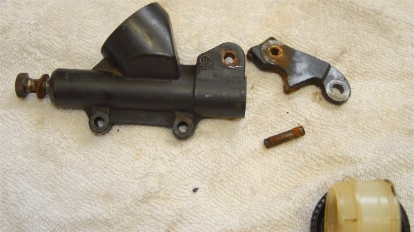

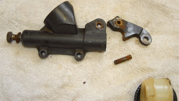

dukabmw
Posts: 5
Joined: Tue May 31, 2011 5:07 am
Re: 900 ss 1981 rear master cyclinder
Post by dukabmw »
Hello
I have just removed and dismantled the Darmahs Rear Master Cylinder and found that by very patiently lightly squeezing the open rim of the master cylinder may have loosened it enough to unscrew easily........ Dismantled pic shown
There is a round seal between the reservoir and the bowl, be careful not to damage it you pull it out
