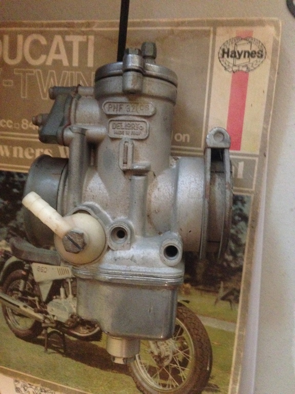

Can anybody tell me the difference between the PHF32A type and PHF32C type carby bodies? I don't see any difference visually apart from the internal parts such as jet sizes, slides etc.
I know they put the PHF32C on some later 900SS models, so the reason I ask is if I put the same jets, slides needles from the PHF32A into the PHF32C types, will it not be the same carby as the PHF32A?

Thanks for trying to answer my question Steve, but both PHF32A and PHF32C types that I'm referring to have the female clamp type fitting (i.e. fitting type B).
See below:
PHF32CS from 900SS or Darmah
Posts: 2396
Re: PHF32A vs PHF32C
Darmah has phf32cd/cs carbies, they have a tiny little jet installed down deep under the pilot (idle) jet from what I have heard is for DOT emissions (SMOG). Otherwise they are the same as the phf32as/ad carbies.

Thanks Steve, I'll have a closer look at that bit of the carbs. These came off an SS but that will be the same as the SD.

Steve is correct, there is another "jet" underneath the A series idle jet. There is one other potential difference...the idle mixture drilling may be different to accomodate a longer and different shaped idle mixture screw with the intent of provisioning some finer adjustment to reduce emissions. There may well be no difference at all in the drilling and it's all down to the needle, but might be worth checking.
CS/CD mixture needle at the bottom, AS/AD at the top.

Thanks Kev, I must pull out all the bits and have a really good scrute!
