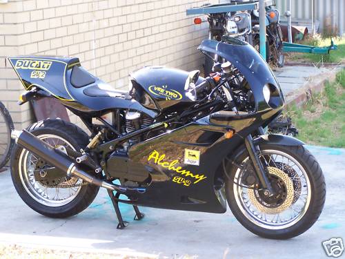

Has anyone heard of the SV-2?

Hello Zanetti, this is the bike I am trying to get some history on.

That is certainly unique, looks like the fuel tank is different from what came with the Alchemy kit as the filler location is further back towards the rider.
afaik there was only 100 SV2 frames made, don't know the number of RV1's
Brook Henry is back in business you should email him the frame# and a pic and see if he could shed any light on what you have.

Thanks Zanetti. This bike was advertised in Perth as an SV-2, I spoke to the owner who said it was a prototype built by Brook Henry in the late '90's and taken to Oz bike shows to keep interest in the Alchemy going. He also said he had a magazine article backing this up, but he could not produce the magazine when I viewed the bike. I did send Brook Henry a photo of the bike, he said he did make one SV-2 prototype which he still has and looks nothing like this bike. He said he thinks a Perth mob made the alternate bodywork sometime in the '90's and offered it to Vee Two, but Brook was not interested.
The compliance plate suggests it is SV-1 #3 and that it was complianced 7/98. Brook said that makes it one of seven pre-production kits he made, and that it may have been a long time in assembly, hence the 7/98 compliance. The bike appears to be a low spec SV-1 under the bodywork, I think the fuel tank is original SV-1, (I will post a photo when I get a chance). It has an '81 Darmah engine with 32mm Delortos, 38mm Mazocchi front end, 08 Brembos and nice Akronts laced to Ducati bevel hubs.
I bought the bike in the end as a SV-1, I believe I can get SV-1 bodywork from Brook for around $1500, (I like the SV-2 bodywork anyway). The bike also came with used racing bodywork (similar style to the photo) which suggests it was raced at some stage, although there is no evidence of this on axle/clipon/footpeg ends etc, and it is very low spec for a racer. I also got an unused additional set of road bodywork.
