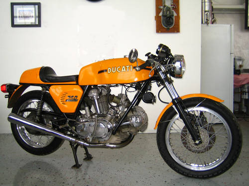

Guys,
I am looking to buy this '74 750 sport. The numbers check out are in our registery. What do you think of the authenticity of the bike? From a value perspective which year '72, '73 or '74 is the most to least valuable or are they all the same?

Looks a pretty correct 74 to me. The picture isn't detailed enough to have a good look at it.

- It looks like it has aftermarket horns on it.
The tail light and mount is US spec.
Whatever is situated just above the horns isn't factory - perhaps some different coil arrangement?
If those headlight ears are chrome they should be verlicchi matt black
The headlight doesn't look quite right, but it may just be the photo.
