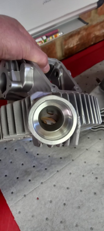

Competition Cycle in Milwaukee, WI does these repairs on a regular basis. I have not used them but have talked with a Mach 1 owner who was very happy with their service. They machine out the worn threads and heat shrink an aluminum insert into the head. The insert is welded around the perimeter and the welds machined off for an invisible repair. The Mach 1 has not had any problems. Cost is $75 and the exhaust nut should be sent with the head to make sure it fits. Call Competition Cycle at 414-672-4010.

HI Russ I would like to know more if you can tell me about this type of repair as I live in New Zealand and would not like to send my front head overseas for repairs. I have talked to my engineer and he is not sure if there would be enough meat around that area to be able to sleeve the head.
Anyway the idea of heat shrinking an aluminum insert into the head sounds good to me, would I have to remove the values and everything because of the small rubber value seals? Also any more info on this type of repair would be very helpful.

There is enough meat to machine out. I machined one out a few years back using a fly cutter on a milling machine. The hardest part is holding the head so that the new exhaust bore is parallel with the original. Just takes a little mucking around during the set up. I made a new insert from phosphor bronze. I then heated the head and shrunk the new insert in. The problem with this is it compresses the ring insert slightly so you should cut the threads a little loose. This insert has worked well for years and the threads are harder than aluminium and less prone to damage.

hi russ regarding stripped threads= its interesting to note that the swiss army solved that problem by insisting from ducati that the exhaust pipes where flanged & secured with 2x 8 mm studs from new!! what ducati did(presumably thy didnt want to change their moulds) by building up the head fins by welding and tapping 8 mm threads into it. which worked very well.no more exhaust problems!!

For readers in the UK, Nigel Lacey ( who specialises in Ducati singles) will do this repair on all Ducatis, my 750 had been repaired badly in a previous life and looks good now.
