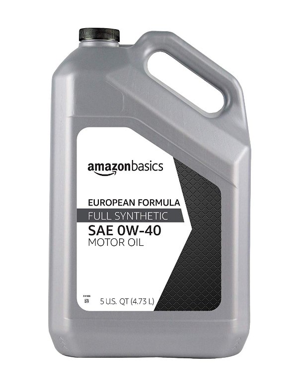

Coming soon in straight 50 weight! I'll see myself out now.

Sign me up for 20 litres!
