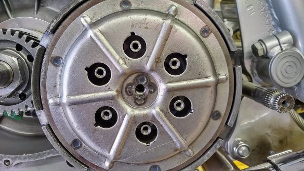

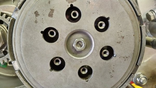

Re: Clutch Basket Bearing Recommendations? 860GT
Upon further examination, it appeared that 3 of the clutch springs and spring cups were binding against the HD pressure plate.
The Gowanloch HD pressure plate is just the slightest bit offset. No matter where I rotate the pressure plate, I cannot get it to perfectly line up against the screw bosses so that they are centered in the opening.
The OEM pressure plate is also not perfectly centered but there's tolerance that I can slide the spring cups in without binding. So, in the interests of the KISS principle, I am reinstalling the OEM pressure plate.
Not sure if you can see the slight offset in the holes of the two pressure plates from my photos attached.
Anyone run into this before?

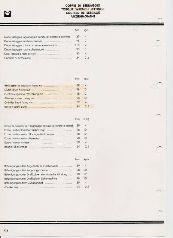

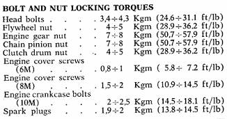

As Old905Duc: I can't remember having seen a spec from Ducati (the company was never very forthcoming about torque valuesherbg wrote: Fri Aug 25, 2017 3:28 pm Question: How much torque is recommended on the screws holding the clutch springs in?
So tight, but not too much ...
Seriously: they're not really doing a 'Job of work,' so don't go overboard. 'Screwdriver tight' is fine.
Isn't there a list with "standard" torques in the back of the manual ?
When all the adjustments run out of range, just put a slightly longer rod in the gearbox-shaft.
Keep in mind that the hole through the shaft has two different diameters.
All other Ducs had about the same system so You could score some parts of those.
As far as I know ...ducadini wrote: Sat Aug 26, 2017 1:13 am Isn't there a list with "standard" torques in the back of the manual ?
The first time that such a thing appeared was in the 1977 Darmah owner's handbook:
And the first workshop manual that had a list (as such)* was the 1981 "900 Replica, 900 SS". It was even less comprehensive ...
* Before that, the few values that were given had to be found, buried somewhere within the text ...
