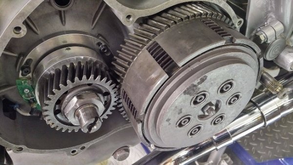

I gave Steve's suggestion a try this morning ... removed the nut from the actuating arm adjustment screw and turned it in as far as it can go. This left no threads exposed for the nut to go back on but wanted to see the effect.
Unfortunately, even with the "extra" leverage, and the clutch lever pulled in, 1st gear does not disengage. The the wheels are fully "locked" into 1st gear.
So, it looks like I have no choice but to take the case covers back off to see what's going on. I do remember having a very difficult time getting the new clutch springs tightened down due to their stiff nature. Might try putting the old springs back in to see if the problem improves.
Really want to avoid replacing the actuator arm and going through the rod and ball sequence again.

Yes, I'm also suspecting the springs. They were very difficult to torque down. I did think it was odd that they were longer than the originals. See the attached photo to see the difference.
Unless there's a reason not to do so, I will replace the heavy new springs with the original OEM springs to see if this helps.

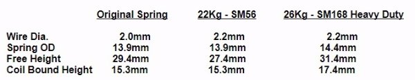

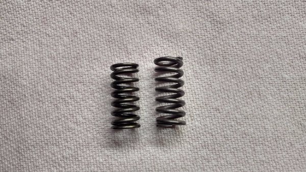

When struggling to install the heavier, longer springs that came with the Surflex clutch, I did not experience flexing of the pressure plate since I'm using a HD unit purchased from Gowanloch. See the attached pic.

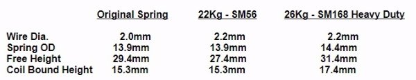

When I was upgrading my clutch I took several spring measurements to try and understand what was going on. I have created and attached a table of the measurements. Click on the table to view in larger size. BTW, that pressure plate looks quite strong!
Both the original and the 22Kg (SM56) springs worked in my application (1975 860GT upgraded to the later clutch design but using original pressure plate and spring cups). The Heavy Duty 26Kg springs would cause the clutch to bind and the pressure plate would not lift. I purchased the 22Kg(SM56) and 26Kg(SM168) springs from from Steve. I am "guessing" that the 22Kg(SM56) springs are the same as the 450 Desmo springs mentioned by Ducadini, but maybe he can take some measurements to confirm(?).

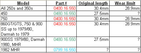

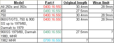

For the recordOld905Duc wrote: Wed Aug 23, 2017 12:59 pm When I was upgrading my clutch I took several spring measurements to try and understand what was going on. I have created and attached a table of the measurements. <snip>
Both the original and the 22Kg (SM56) springs worked in my application ... <snip>
1. All 250s and 350s
Part #: 0400.16.550
Original spring length = 30.4mm. Load to reduce spring length to 20mm = 17kg. No minimum spring length given, but see below under the 860 entry.
2. 450
Part #: 0480.16.550
Original spring length = 27.5mm. Load to reduce spring length to 20mm = 21 kg. No minimum spring length given.
So both shorter and stronger
3. 750s
Part #: 0400.16.550, i.e. same as 250s/350s.
The workshop manual is silent on the spring length (but see both above and the next entry).
4. 860GT/GTS, 750 & 900 SS up to 1979/80, Darmah to 1979
Original spring length = 30.4mm. Limit of wear = 28.9mm.
5. 900SS 1979/80, Darmah 1980, MHR
Part #: 0480.16.550, i.e. same as 450s.
Note: The consequent reduction in the free spring length is NOT reflected in the workshop manuals for either model.
6. 1982 MHR
New spring, part# 0799.16.550.
Haven't got the size details, and my brain is beginning to hurt ...

Re: Clutch Basket Bearing Recommendations? 860GT
Eureka, I have found it!
Thanks to all that have contributed to this thread. I now FINALLY understand why the Heavy 0799.16.550 clutch spring did not work in my application or (likley) in Herbg's. Each of the replies to this thread added pieces that led me to my conclusion. Thanks all again! Here is my assessment.
The last reply by Craig identified that the Heavy spring 0799.16.550 was introduced on the MHR models. This prompted me to to dig deeper into the spare parts manuals on Steve's web site. Here is what I found ..........
Heavy clutch spring 0799.16.550 was introduced optionally or part way through the 900 MHR model run. Use of these springs also coincided with the use of longer clutch spring screws and a new clutch hub. This design change was then fully applied to the 900 S2 model. So, in order to use the Heavy springs you also need to use longer screws and revised new clutch hub part number 0799.16.590 instead of previous hub part number 0759.16.594.
So, in my case as well as Hebg, we have hub part number 0759.16.594 which is not compatible with the longer Heavy springs. Also the spring screws need to be longer. In my case I determined this empirically, but still had issues due to the wrong clutch hub. Without seeing the design changes in hub 0799.16.590 I would speculate that the spring post height was modified to accommodate the longer springs and longer screws.
The bottom line as I see it is that you cannot use Heavy springs 0799.16.550 unless you also have clutch hub 0799.16.590 and the corresponding longer screws.
So, my advice to Herbg is to either use his original springs, or the 22 Kg p/n 0480.16.550 (SM 56) that Steve sells to get a fresh set.

As so often, Ian Falloon tells the story. I quote (my underlining):Old905Duc wrote: Thu Aug 24, 2017 9:10 pm Eureka, I have found it!
Thanks to all that have contributed to this thread. I now FINALLY understand why the Heavy 0799.16.550 clutch spring did not work in my application or (likley) in Herbg's. <snip>
"After engine number 091267 there was a new clutch housing, with longer clutch springs and six longer (5x16mm instead of 5x10mm) Allen screws. The earlier springs and screws were not interchangeable with this housing"
This is 1981, btw.
Source: Falloon, 860 etc Bible, page 101.
