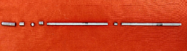

Since I've got the clutch & shifter assembly apart on the 900SS, I ordered the Clutch Rod & Ball (small) Kit (among other items) from BevelHeaven.
Finally getting around to removing the existing rods and balls from the bike (with the excellent tips from this post in hand). My 1978 900SS is a bit of an odd ball - unlike any other Canadian 1978 model as this bike was purchased in Europe. It's effectively a leftover 1977 blue/silver build with engine 087599 but many 1978 features.
Anyway, to my surprise, it appears that rod no. 47 is missing from the end of the assembly. See the photo below:
Then, I measured this rod & ball assembly for future reference. Here's the measurements, using the numbers highlighted in the Parts Manual:
No. 45: 26.35mm X 7.85mm (Length x Width)
No. 44: 7.91mm x 7.93mm
No. 46: 7.91mm
No. 43: 113.45mm x 5.97mm
No. 47: 6.50mm x 6.14mm
No. 47: Missing
There is a minor discrepancy with rod No. 47. from BevelHeaven's kit as it measures 5.99mm x 6.00mm. While I'm sure the 0.50mm isn't a big deal, I wonder which is correct. I'll be installing BOTH No. 47 rods from Steve's kit which should get things back to normal.
I'm also wondering about the measurements for Rod. No. 45.
Anyway, I'm interested in your comments on what I measured.
