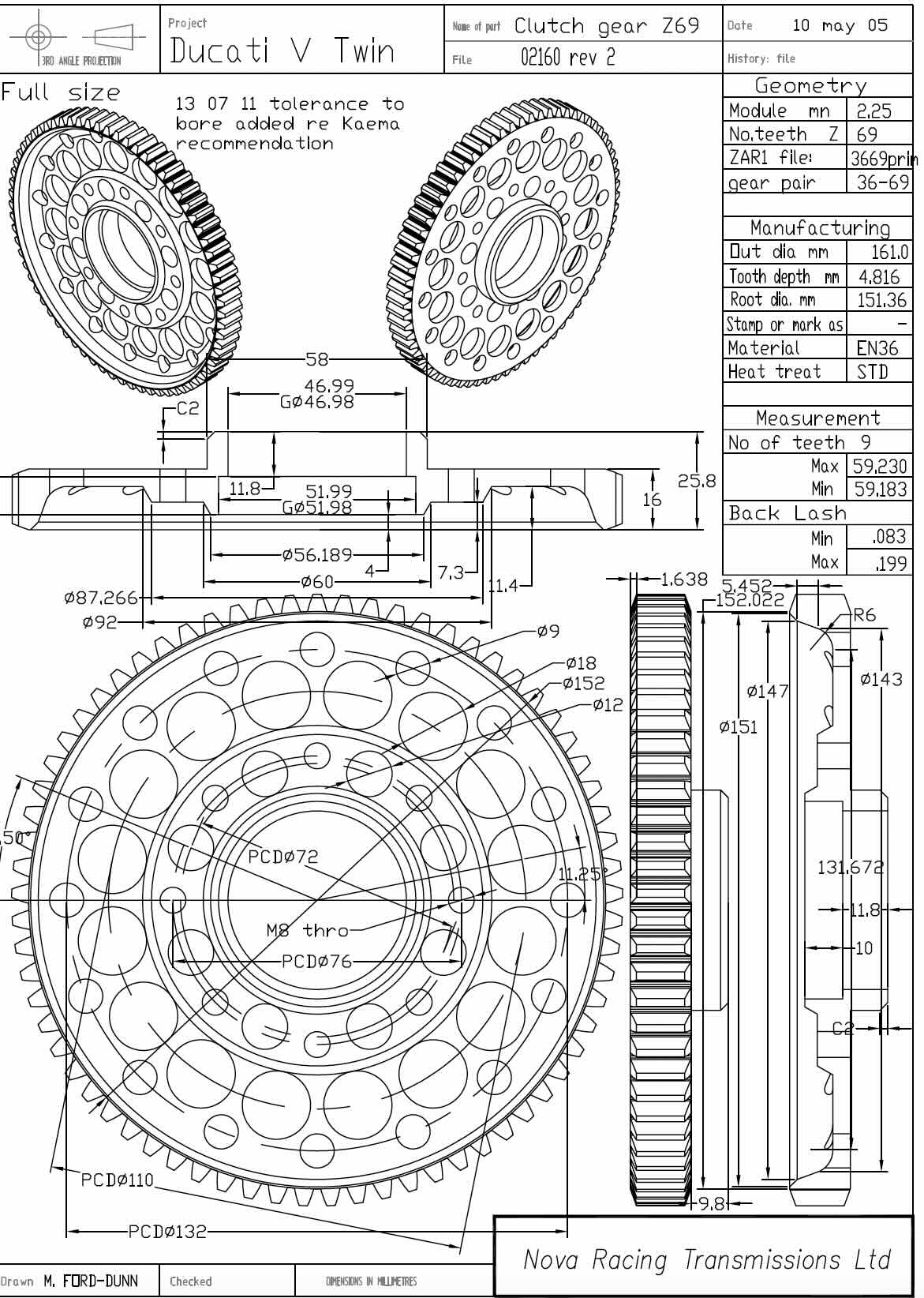

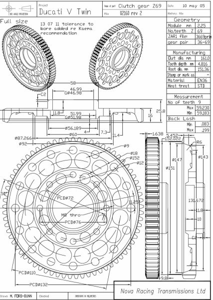

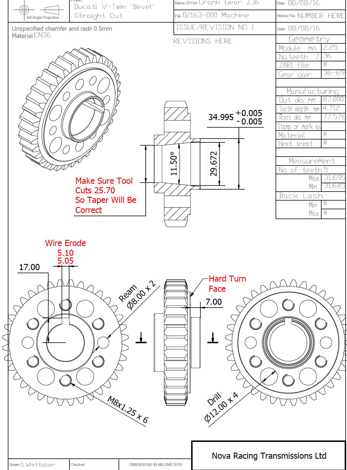

Since veetwo don't have any in stock I decided to make a kit via Nova in uk.
They can start making a kit at the end of this year and the cost would be around 800 pounds.

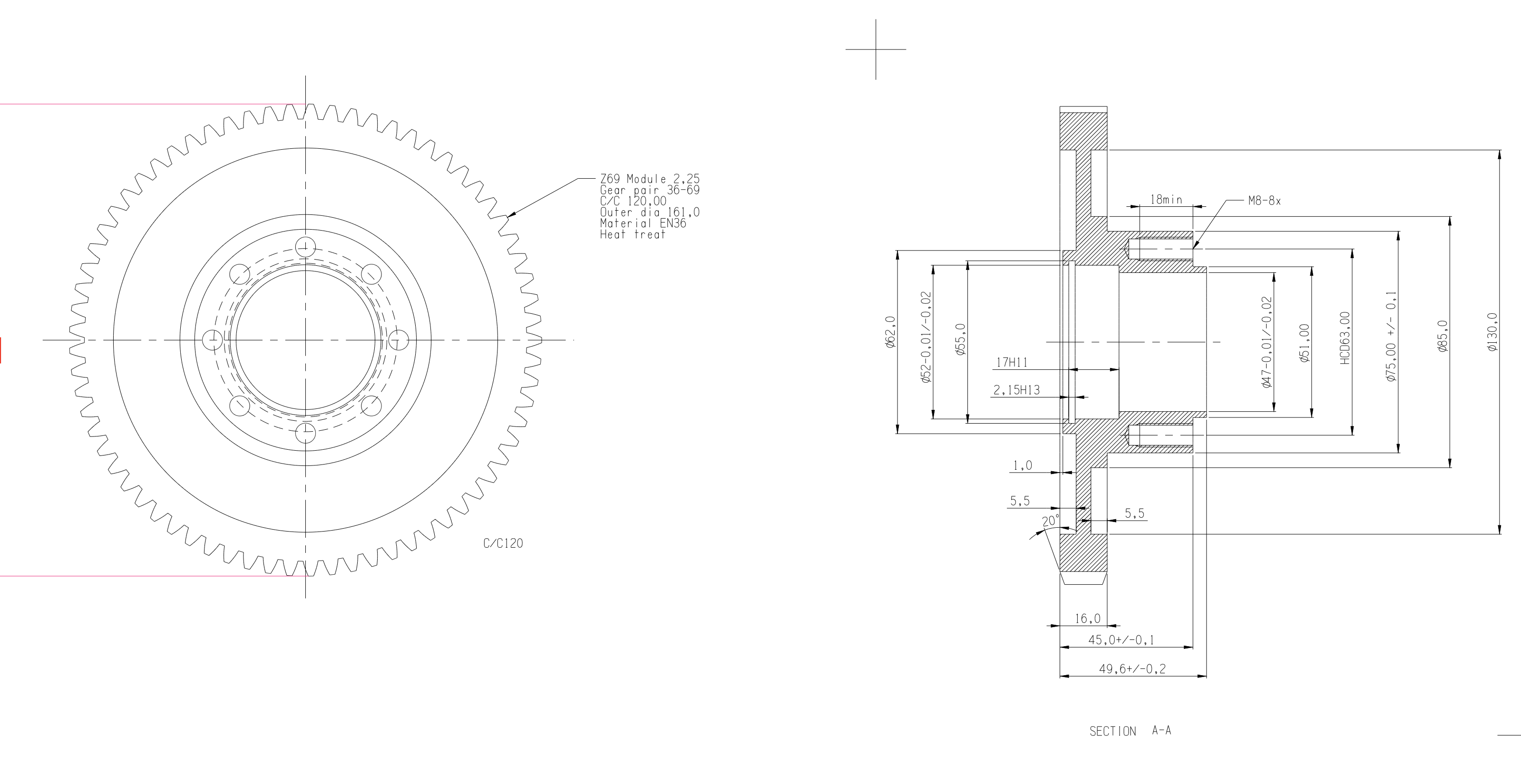

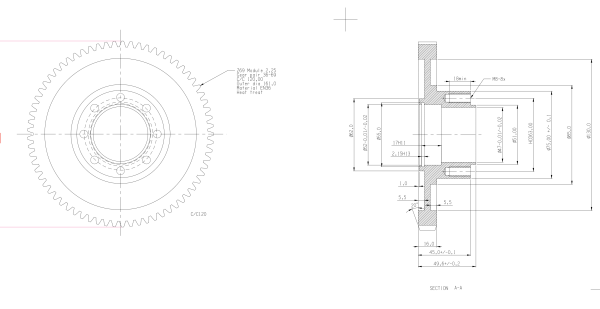

My friend has helped me with this drawing.

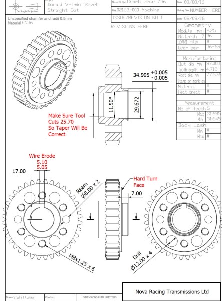

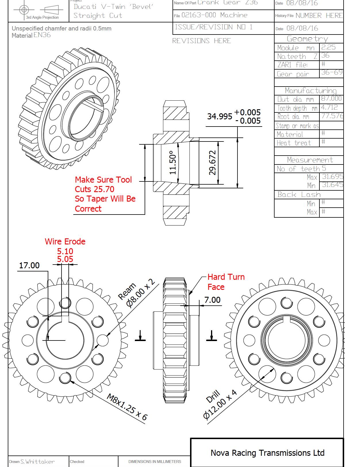

I'm going to use a modern Ducati clutch.
I also put in Novas drawings for the wetclutch bevels.
The distance between the the mainshaft and the crankshaft is 120.00mm. On the Darmah crankcases that I've got had a distance of 119.987mm.
I'm still looking for a front gear for the Mille.
If someone can measure it or if someone can lend me one or if someone has one for sale it would be much appreciated.
Draft of Mille straightcut gear
