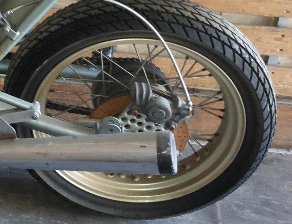

It could be that procedures were a bit changed since the 80's but when I had my rims anodised then, they came out rather dull, and CERTAINLY not so shiny as a polished or chromed rim.
After 30+ years of storage
I had two sets, and the other set is just the same, rusted discs but everything else is dusty. No coating, just a blast with the pressurecleaner before storage.
I suggest You ask some good pics of the anodised rim before ordering them.
