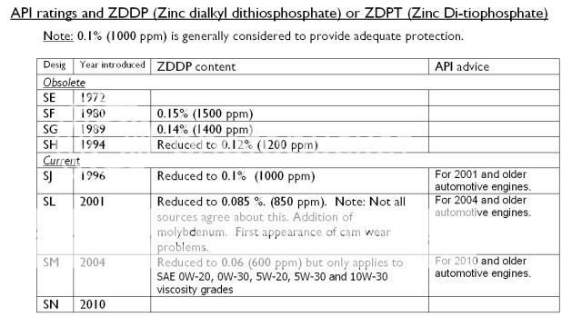

Just to keep the pot boiling ... :blah: . A couple of reflections from the industry on ZDDP:
1. Caltex
"The old zinc/phosphate based anti-wear additives are not the only way to achieve anti-wear chemistry. (…) It isn't appropriate to compare the anti-wear properties of an oil by considering the zinc content alone.
Some of the concerns about modern engine oil chemistry are raised by third party oil additive companies, who need to tell such stories to market their unnecessary products. Generally, modern oils benefit the older engine designs, and there is no need to seek out low quality oils, or to add extra unnecessary additives."
James Cull
Caltex Customer Services
Chevron New Zealand
2. Silkolene
"As for this ZDDP business, it's not just a simple 'High Zinc Good, Low Zinc Bad'. Suffice to say that oils with adequate, but not unnecessarily high, ZDDP levels are fine, especially if the load-carrying is boosted with synthetic ester and the oil film thicknesses are maintained by shear-stable polymers.
Zinc level in the (Silkolene) Pro and Comp grades is 1100ppm."
http://www.silkolene.com/index.php?calling=oilclinic
P.s FWIW: Silkolene Comp 15-50 is what I use these days ... :vroom:

Main issue is with the industry blokes' statements is that modern metallurgy has overcome a lot of wear issues and modern oils plus modern metallurgy equals better fuel economy, longer oil changes etc. (a lot forced by government laws as well and I am generalising here as the info takes a lot to absorb) but the older engine metallurgy can have problems (mainly top end). As I said previously, check the classic car sites and talk to rebuilders of older machinery as the newer, lower ZDDP oils may not make the grade. They have added other substances for lubrication and most have gone to Ca based detergents from memory.
I am not sure if our older metals/systems like these materials either.
Most of the long time bevels I am aware of have done a number of good things. Main one as Ken and I have said is to change oil (and filter) very regularly plus the way they are ridden has a big bearing (pun intended) on it. Lug them in top gear at low revs and wait for the hand grenade!
