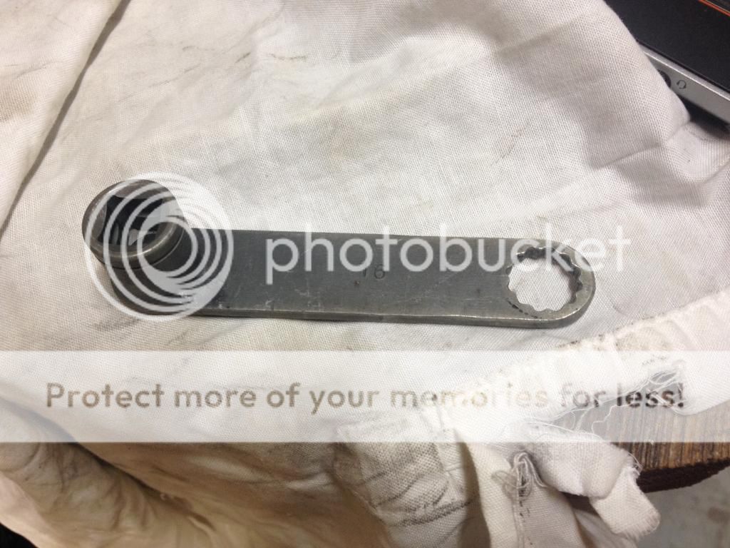

(Hopefully I'll never need one, but ....) Ooh - that looks nicemachten wrote:I got one of these that used to be sold by a Queensland gentleman.
Not this fella by any chance, Kev?machten wrote:He made quite a selection of good Ducati tools for singles and twins.

No worries. Just note, Richard, if you do decide to make you own tool, you need to use a 12 point spanner, not a 6 point one. You'll see that both the one Andrew sells and the one Kev has are 12-pointers. There's not a lot of free space around those nuts

I also usually stock the head nut spanner shown above with 16mm 12 point that has been ground narrow on the outside edge so you can use it . Snap in your torque wrench perpendicular to the wrench and use the factory torque spec. I'll have more shortly...

Also 'Good to Know' <>BevHevSteve wrote:I also usually stock the head nut spanner shown

I cut the end off an open ended spanner and welded a socket to it so you end up with a tool as short as possible (about 40mm long) to minimise the effect on torque reading. You do have to grind the sides of the spanner down to fit in the limited space but with a bit of patience with a hammer and a file you can actually 'dress' the spanner size in very close on the head nut size (a lot closer than a stock spanner) which makes it work a lot better. A ground down spanner is always going to open a bit under pressure but if you close it up nice and neat to the nut size it lessens the chance of damage or slipping. I used to work in a big engine rebuilding business and actuall used the torque wrench calibrater we had to do an experiment to see how much the extra 40mm in length affected the torque setting on a standard 1/2" drive 2 foot long torque wrench.
It doesn't. I did it a few times as I was surprised but it's true. Just set it to the setting you want and go for it. Something that has much more of an effect is not putting oil on the head studs. The fact you are having a pregnant dog of a time getting the head nuts off means to me the last bloke never put oil on the studs so it was probably the wrong torque setting anyway. I made a lapping tool for the fire ring to make sure it was flat, in all the bevel heads I've had off they have all had shrinkage on the fire ring right next to the exhaust valve seat. Doesn't matter how accurate the torque settings are if the fire ring isn't flat...
