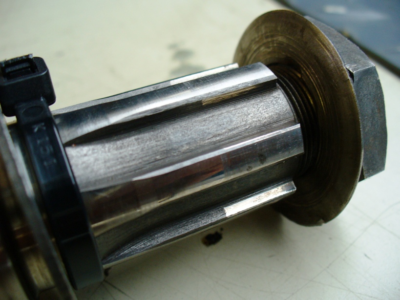

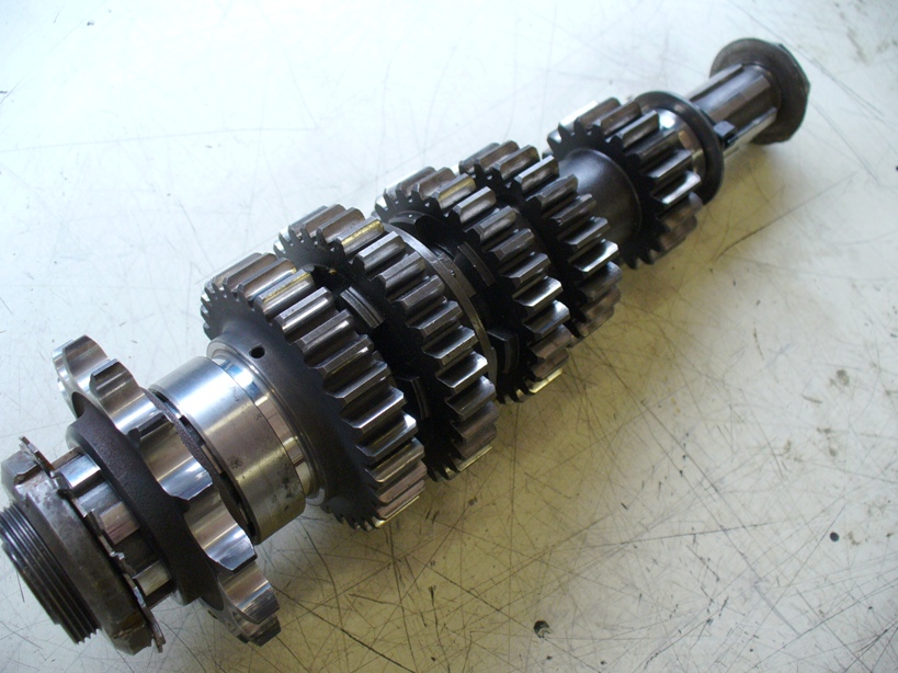

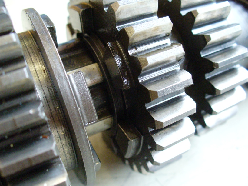

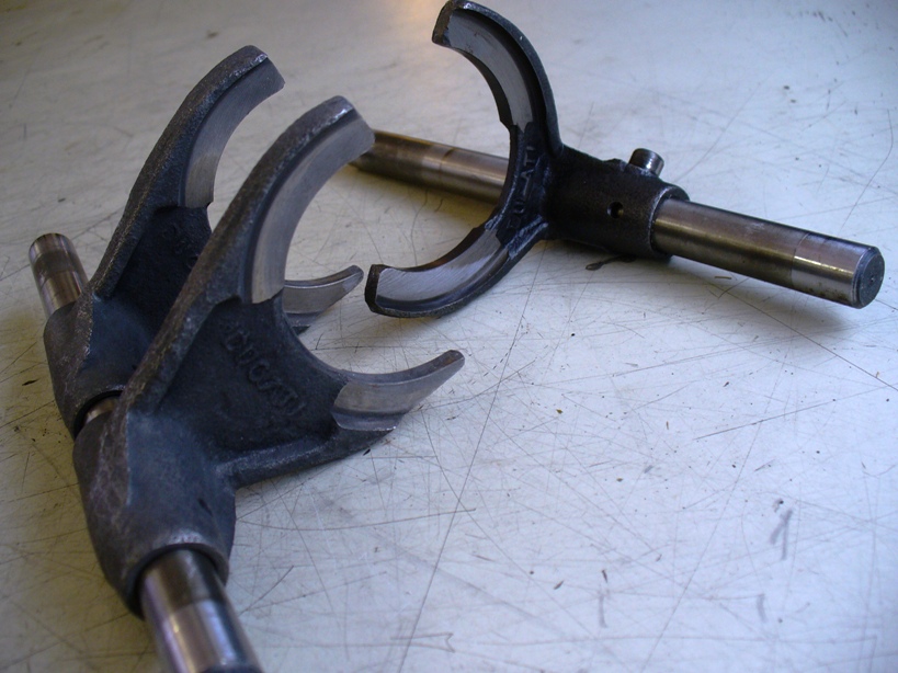

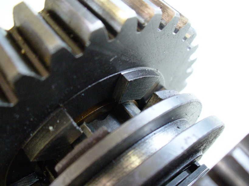

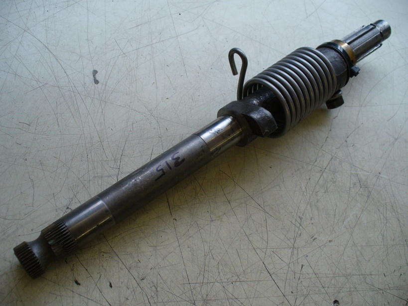

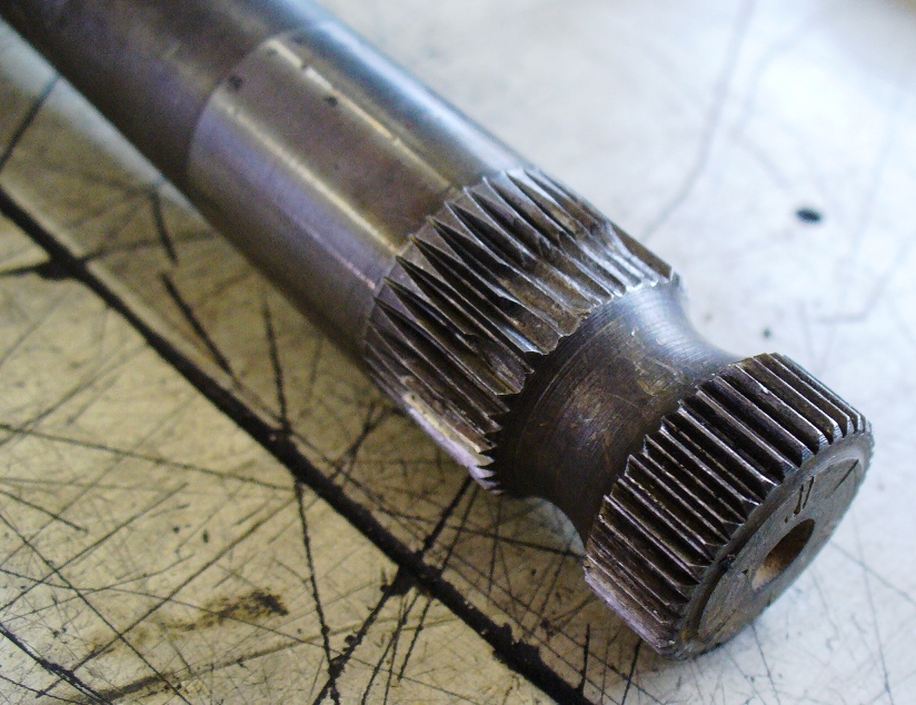

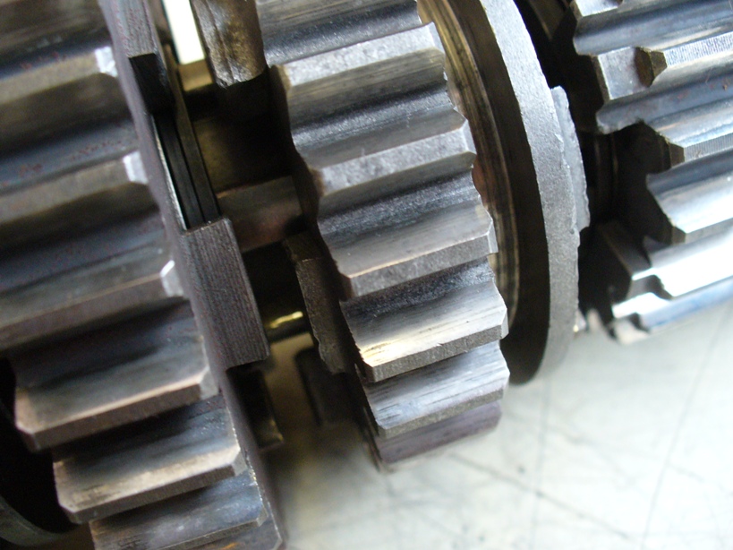

Looks like except for the kick-starter shaft splines, the gearbox is in pretty good shape. Engagement dogs show only a little wear and no chipping. no corrosion damage or tooth galling.
Layshaft 5th gear is , oddly, a quite tight on the shaft when you withdraw it from the shaft across the adjacent splines, though spins nicely on the shaft where there looks to be a little wear on the spline top wear surface. Will be inquiring with learned sages about what might be necessary to do with this. I see that grinding some lube access notches in the gear is one approach to improving:
https://www.facebook.com/photo.php?fbid ... =960%2C642
[img]hhttps://i.postimg.cc/q7FBByz4/shift-drum.jpg[/img]

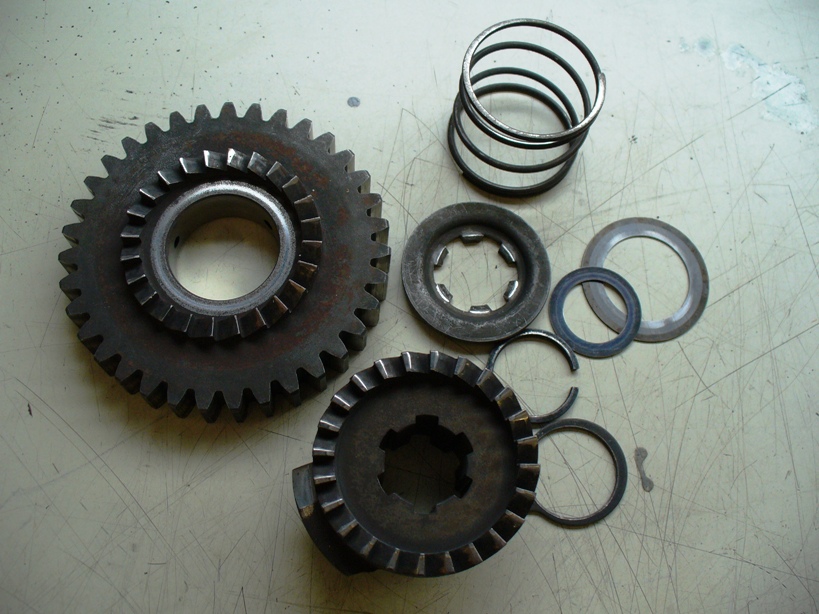

Clutch and primary looks pretty good over all.
Considerable notching on the hub. At $100 for a new steel replacement from HDESA, no reason to try to dress them out. The small bit of notching on the basket ears can be filed out.
The steel plates have considerable wear on the drive tabs so will be replaced.
Friction plates don't look too bad though wondering about alternative friction plates like the Kevlar ones from Gowanloch in Australia:
http://ducati-gowanloch.com/catalog/bev ... -3022.html
I've sent him in email to ask if they allow you to use lighter clutch springs and get the notorious clutch pull effort down a bit w/o having to go with the extended actuator arm or the hydraulic rig from here:
http://fezone.com/mms/
Considering cutting down the flywheel to lighten a bit and perhaps let it rev a little easier and (if similar Guzzi practice translates) make it shift a little smoother.
Clutch push rod long items are corrosion pitted, but serviceable. Small bits and balls will be replaced with new.

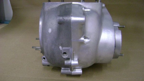

The project is coming along. The cases, heads & barrels are bead blaster & cleaned. Engine hardware is at the plater for electroless nickel and a little black oxide (head nuts). Timing & clutch covers at the the polisher.
Crank / rods is at Guy Martin's in Montreal for overhaul / modification.:
http://www.mbpducati.ca/index.htm?guyma ... ~mainFrame
Various parts have shown up and more to come.

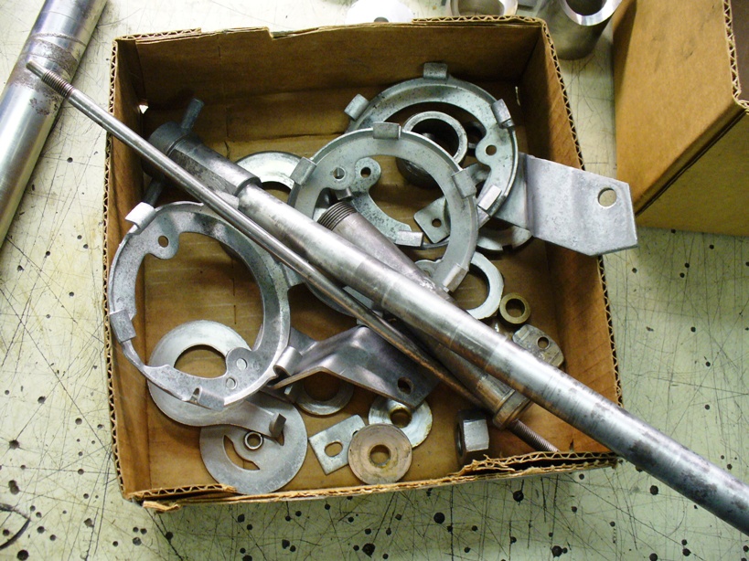

Now time to tear down the rolling chassis. No real surprises until taking the rear wheel apart. Looks like more damage from the pitched chain incident that broke the R.H. engine case. The sprocket carrier is toast - pieces broken out of the bolt hole areas in the casting as well as big cracks from the same. It could be welded up and re-machined, but hope is to find another (see I just missed one on UK eBay ............ damn!).

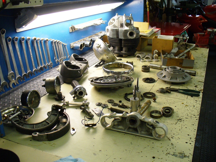

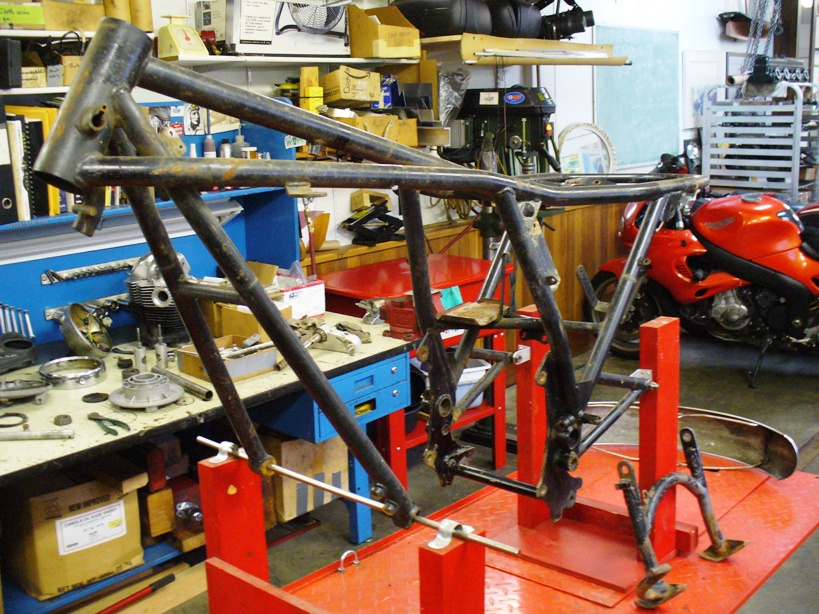

More tear-down
frame is completely stripped right down to the lock. Will go this week for garnet blasting with a head guard installed. Found out the hard way that if it gets dropped on the steering head and bent, it's difficult to impossible to straighten it. After blasting, I'll take it and the swing arm to friend Paul Brodie's shop to check its straightness on his tricky frame jug.
http://flashbackfab.com/

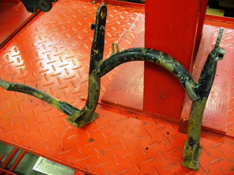

Center stand is bent and that side's foot is worn down. Will be weld built up and ground flat and bent leg straightened.
Swing arm has some gouges in it that will be filled with JB Weld and smoothed out. JBW is good up to 650F so it's finfe for the powder coating process. Rear fender is a bit beat up and will be replaced most likely with a generic item from Wolfgang in Nakusp. Seems a shame to paint a good INOX front fender, but that's the plan for the fenders at the moment.
Various bits will be going to electroless nickel plating, re-chroming or aluminum polisher. Don't do aluminum polishing any more - too filthy and not nearly as nice a job as Green's Wheel Shop in Richmond BC.
Various and sundry bits to contemplate. Gages going to Oliver in White Rock BC for refurb. Tried to press out the steering stem from the lower triple clamp, but heated to 350F and at 20 tones, it didn't budge. Have to think about that one, Screwed in? Seems unlikely. The threaded ends on the chain adjuster cylinders didn't budge when heated and using jam nuts to get out for plating. Hate to have to drill them out. Maybe more heat and Aero Kroil.
Well off to go look at a 1927 Grindlay Peerless that a guy wants to have restored. Job would be split between me & local Guzzi "Slicer" single owner Alan. It's like this one:
